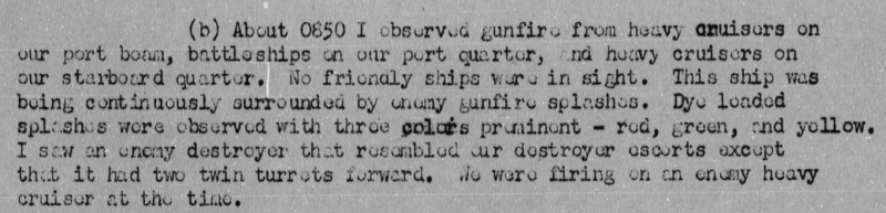

Kongo red colored dye again will look purple when viewed in blue water. Japanese reports are specific in writing BB caliber rounds as Type 1 and 8-inch and 6.1-inch as Type 91. In Bureau of Ordinance OP 1667 Japanese Explosive Ordnance no 8-inch or 6-inch shells had dye bags and no type 91 projectiles had dye bags. They are specific to Type 1 AP projectiles. The only ships to receive Type 1 projectiles are the battleships.
Heermann documents red died shells hit her. That matches Kongo. Kongo is behind Heermann and Tone is ahead of Heermann. Of the three hits one comes from forward and is reported as an 8-inch shell hit and that works out because Tone is shooting at her so this matches. Two shells came from aft and traveled forward through the ship. Heermann documented large caliber hits and the damage inflicted supports BB caliber rounds. Since BB caliber AP rounds are the only ones with a dye load and Heermann recorded red shells hit her and the Kongo records sinking a destroyer at 0902 when Heermann has lost 17 ft freeboard forward and looks like she is sinking by the bow. Now the range of 30,000 yards. This is based on the track charts and distances given within their reports. Kongo, Yamato, and Nagato are all close to each other at 0850-0900. They she gives the same bearings to either taffy 2 or taffy 3 at the same times. If Kongo was closer she would have at some point traveled faster than she could and she would be giving different ranges and bearings than she did. If she was closer she would have seen Heermann hit like Tone who witnessed the hits and thought she had exploded. Kongo was simply walking her fire up 100 yards at a time and Heermann was at the very edge of her visibility. The 30,000 yards is just a ball park figure but she was not close.
No i tu jest problem, bo za raportem oficera artyleryjskiego z Heermanna były trzy kolory.
Pancernik był z przodu (port quarter, krążowniki z boku). Co do trajektorii w poziomie to bym większej wagi do tego nie przywiązywał. Przecież Hermann nie płynął stałym kursem pewnie nawet przez minutę – ciągle zygzakował. Co innego trajektoria w pionie – wydaje się wyjątkowo płaska, jak na 30 tysi.
Według mapki bosamar Kongo też był z przodu.
http://bosamar.com/files/0850_overview_web.jpg
Raport Hermanna nie pisze o “large caliber”, ino “heavy shell” i precyzuje, jako 8 cali. Na temat kto strzelał drabiną 100 jardową już wspominaliśmy wyżej.
