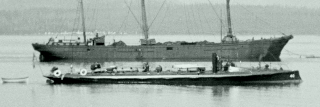

Re: Ttorpedowce wojny chilijsko-peruwiańskiej
Wedlug Memoria 1885 str XVI
Byly sprzedane torpedowce LAURA i GLAUCA za £20,000
Czyli nie jak to podaja zrodla byrtyjskie (Lyon, Colldege, Winfield) GLAURA i FRESIA
Zreszta Lyoan podaje w Steam Navy ze byly zakupione w 1888 roku.
40t disp 100' x 12'5" x 5'
2cyl compound 500ihp locomotive boiler
15 zalogi
2 Nordenfeld 2x14"TT
Britannia's Navy on the West Coast of North America, 1812-1914
Barry Gough
tez podahje ze TB.39 & 40 weszly do sluzby w 1885 roku-
Czyli dzieku Napoleonowi rozwiazalem problem,
byl balagan spowodowany przez przepisywaczy i kompilatorow
Tak jak napisalem, regula nie wiez nikomu sie sprawdza.

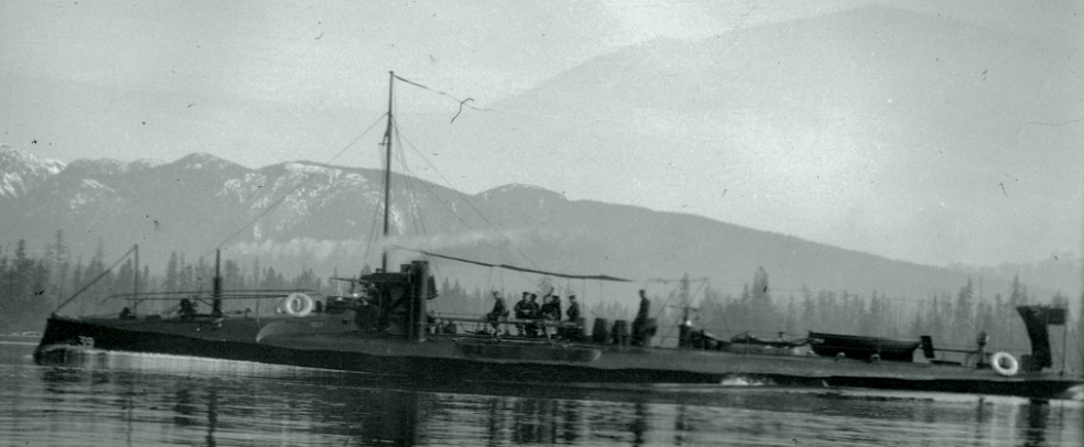

TB 40 c1900 [C.P.R. coal hulk "Robert Kerr", next to a torpedo boat in Burrard Inlet]
15 zalogi
Barry Gough

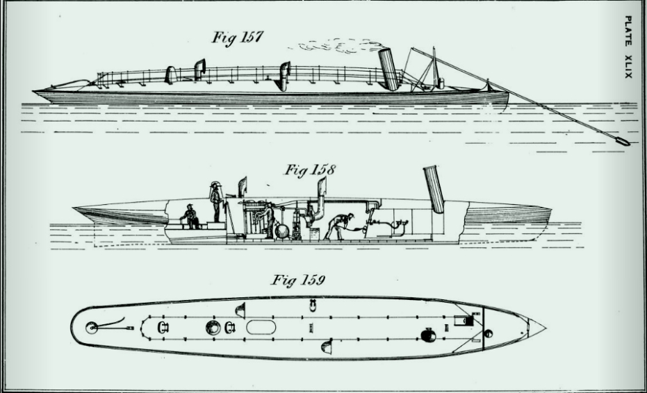

Description of a Yarrow Torpedo Launch.—Figs. 157, 158, and 159 show an elevation, section, and plan of a torpedo boat, Yarrow type, a large number of which have been built for the Russian and other continental governments.
The length of this boat is 75 feet, its beam 10 feet, and draught of water 3 feet. She is built of steel of the best quality, no other metal possessing the requisite strength and stiffness for scantling, and plates of such lightness. It is divided into eight compartments by seven transverse bulkheads, the forward and after compartments being used for stores, the two central ones enclosing the machinery, while the steersman and operator are placed in the compartment immediately abaft the engines.
The steersman's head projects above the deck, and is protected by a rifle proof steel truncated cone, the top part of which is movable like the visor of a helmet. The hull is decked over from end to end with a curved shield, the midship plating of which is capable of resisting rifle shots, even at close quarters; its curved form being well adapted for giving the maximum strength to the structure, and quickly frees itself from any large body of water.

Ten schematyczny rysunek (fig 157 i 158) jaki torpedowiec przedstawia?

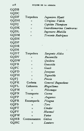

FRESIA musial istniec jeszcze w 1901 roku, bo przyzunanpo mu sygnal
"Manual del marino. Recopilación de leyes, decretos, ... 1900-01.
- AvM
- Posty: 7305

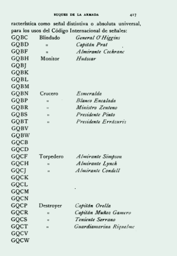

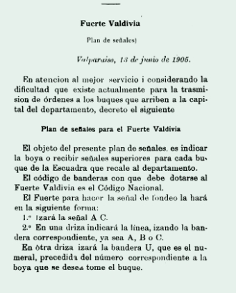

"Manual del marino: Recopilación de leyes, decretos, reglamentos y órdenes de carácter general referentes á la marina chilena"
W 1905 jeszcze przyznano sygnal rozpownawczy
