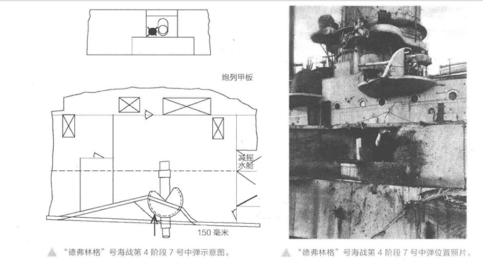

A to jest tak blisko "furty", że ją poszerzyło:

Michał, to jeszcze 21 trafienie Lützowa za "German Battlecruisers of World War One":
"At 20.15 a 13.5in shell from either Orion or Monarch struck the right barrel of A turret and detonated just outside the gunport. Splinters showered into the turret, the aft hoop was torn off the barrel of the right 30.5cm gun, which was jammed. The left gun was protected by the splinter shield inside the turret and remained serviceable."
