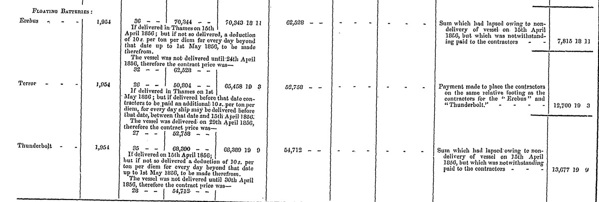

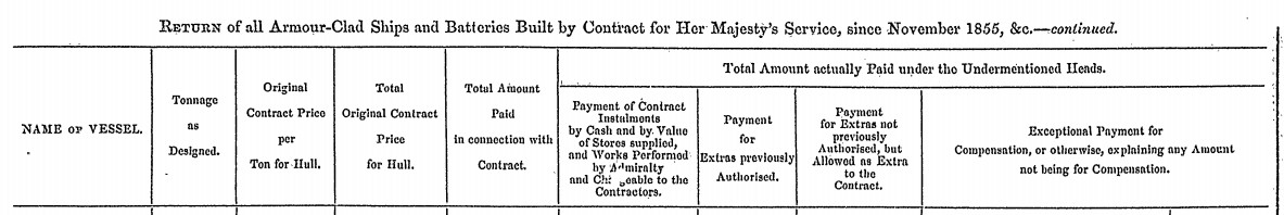

Tutej ciekawostka, dotyczaca kosztow wynikajacych z kontraktow
NAVY (ARMOUR-GLAD SHIPS AND BATTERIES).
RETURN to an Order ofthe Honourable The House of Commons, dated 28 June 1867 for,
RETURN *'of'all ARMOUR-CLAD SHIPS and BATTERIES Built by Contract for HER.MAJESTY’S SERVICE since November 1855; giving,—
1st. Amount of Original Contract in Price per Ton, and Total Contract Amount;
2nd. Total Amount actually Paid under the following Heads:—
1. Payment of-Contract Instalments by Cash, and by Value of Stores supplied and Works performed by Admiralty, and chargeable to the Contractors;
2. Payment for Extras previously authorised;
3. Payments for Extras not previously authorised, but allowed
as Extra to the Contract;
4. Exceptional Payments for Compensation or otherwise, explaining any Amount not being for Compensation.”

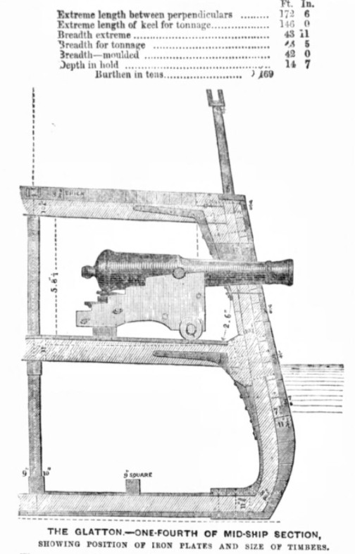

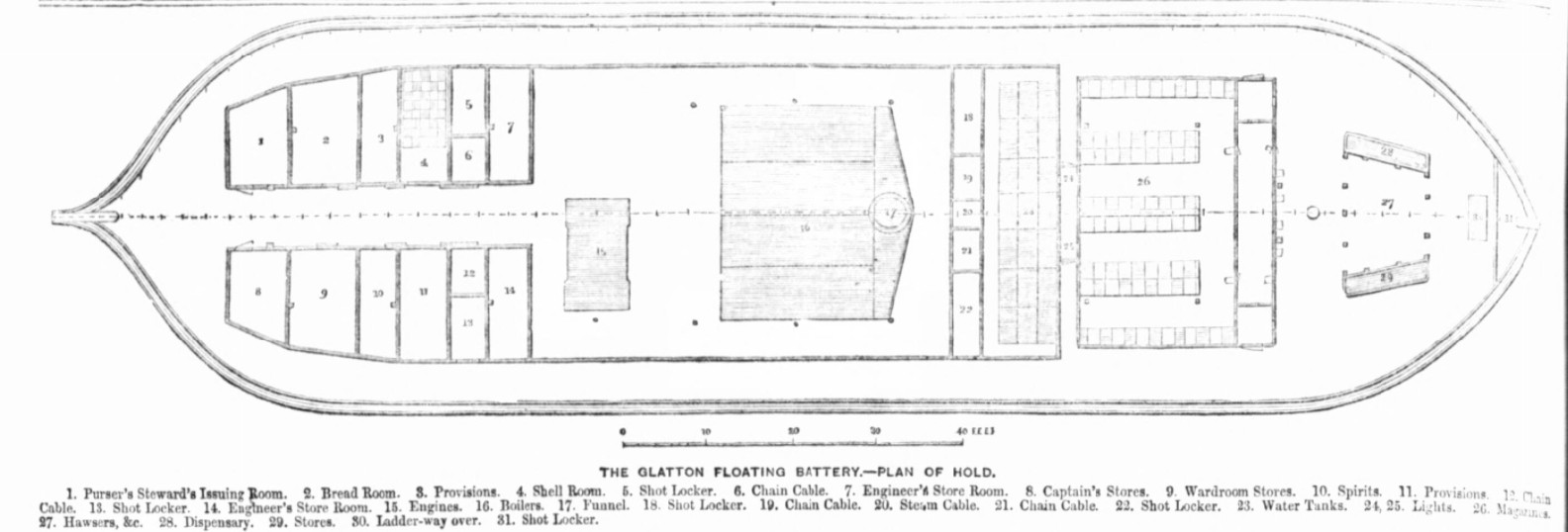

Re: Pancerne baterie w wojnie krymskiej / recenzja
Illustrated Times - Saturday 15 September 1855
Illustrated Times - Saturday 15 September 1855 GLATTON -2.jpg (114.89 KiB) Przejrzano 9140 razy
Illustrated Times - Saturday 15 September 1855 GLATTON -3.jpg (66.78 KiB) Przejrzano 9140 razy

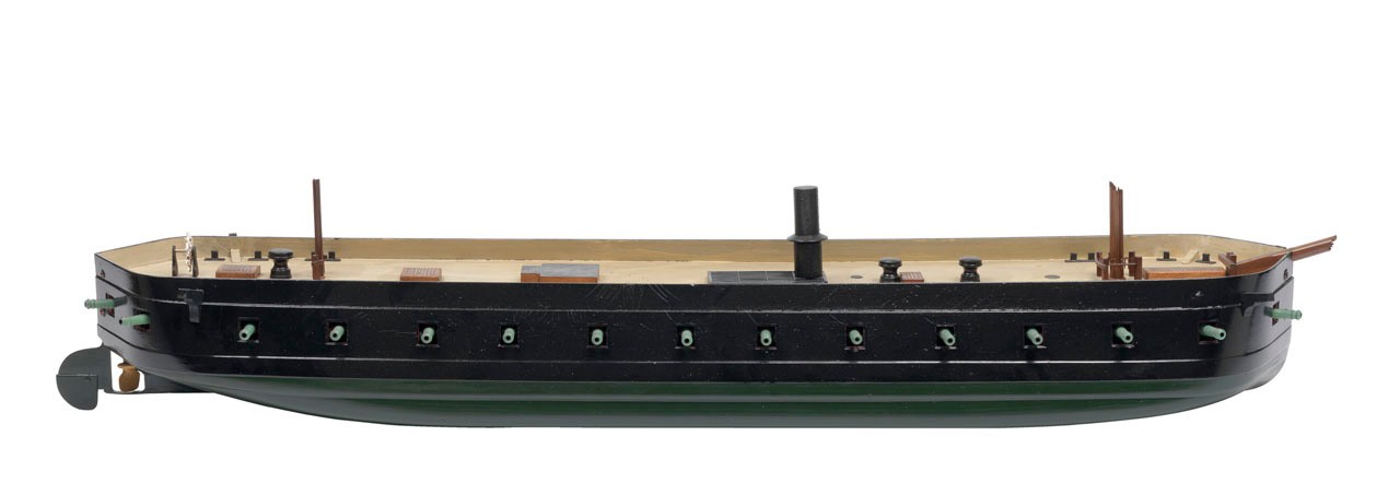

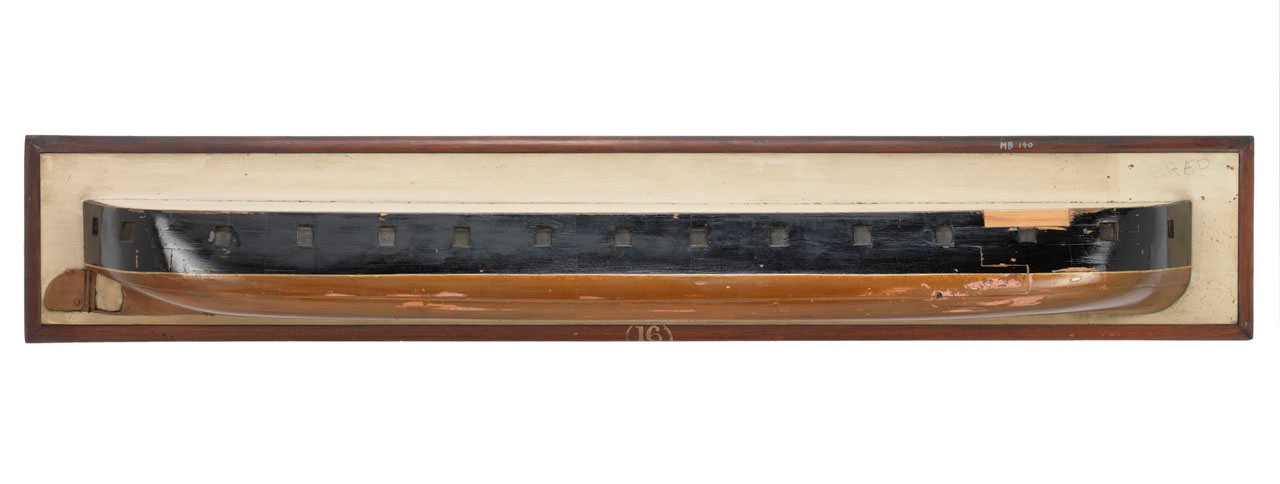

NMM Model EREBUS
C2 Erebus hull NMM.jpg (77.33 KiB) Przejrzano 9139 razy

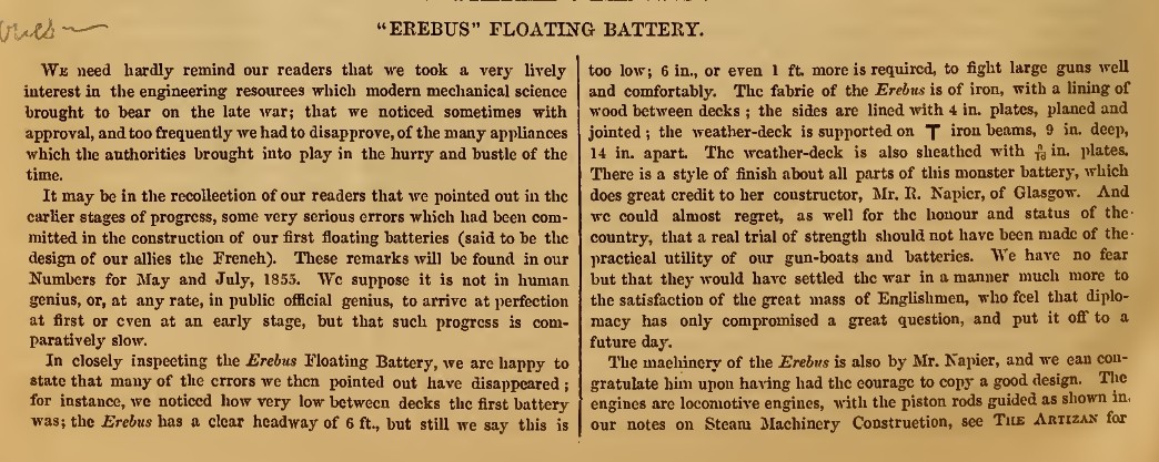

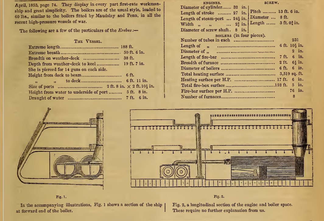

The Artizan 1 Oct 1856
The Artizan1 Oct 1856 p.221 EREBUS-1.jpg (174.27 KiB) Przejrzano 9137 razy
The Artizan1 Oct 1856 p.221 EREBUS-2.jpg (211.22 KiB) Przejrzano 9137 razy

W artykule nie sa podani producenci maszyn dla angielskich zelaznych baterrii typu EREBUS (no nie ma cih w wikipedii, wiec skad przepisac :)
EREBUS mial maszyny Robert Napier & Sons, Glasgow (maszyna No. 179)
THUNDEBOLT mial maszyny Miller, Ravenhill & Co
TERROR mial maszyny Robert Napier & Sons, Glasgow (maszyna No. 180)
Nie mam zadnych informacji zeby ktorys z tych okretow robil proby prodkosci i mocy.

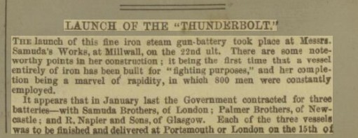

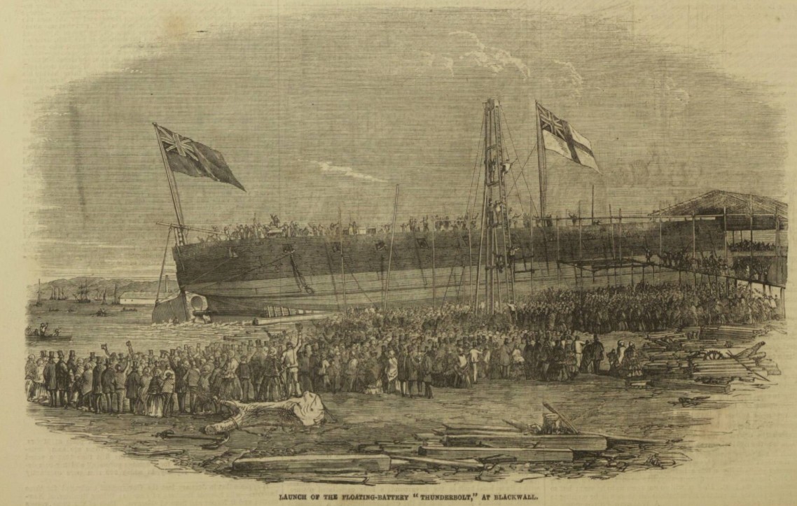

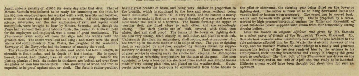

Illustrated London News - Saturday 10 May 1856
Illustrated London News - Saturday 10 May 1856 THUNDERBOLT -1.jpg (28.82 KiB) Przejrzano 9120 razy
Illustrated London News - Saturday 10 May 1856 THUNDERBOLT --2.jpg (149.98 KiB) Przejrzano 9120 razy
Illustrated London News - Saturday 10 May 1856 THUNDERBOLT --3.jpg (213.32 KiB) Przejrzano 9120 razy

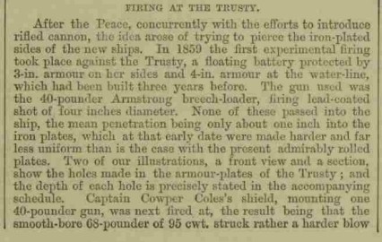

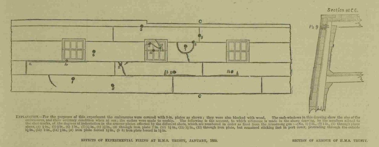

Illustrated London News - Saturday 05 April 1873
Illustrated London News - Saturday 05 April 1873 TRUSTY --1.jpg (90.19 KiB) Przejrzano 9113 razy
Illustrated London News - Saturday 05 April 1873 TRUSTY --2.jpg (40.29 KiB) Przejrzano 9113 razy
Illustrated London News - Saturday 05 April 1873 TRUSTY --3.jpg (6.22 KiB) Przejrzano 9113 razy
